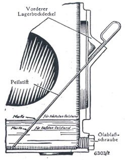

Many thanks....that's brilliant thank you! (I have had no help in uk...and had virtually given up until finding this forum). Mine doesn't have a dipstick at all ( no provision on crankcase). Was this normal please?

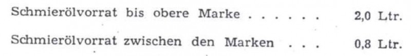

Sorry...another question. Am I correct that oil capacity of crankcase sump should be 2 litres?

ribbo hat geschrieben: Mo 14. Aug 2023, 08:41 Mine doesn't have a dipstick at all ( no provision on crankcase). Was this normal please?
The normal version should have a dipstick.
Dipstick Deutz MAH 711
Yes, the manual says 2 litres (max. oil level, min. oil level is 0.8 litres less:
Oil capacity Deutz MAH 711
