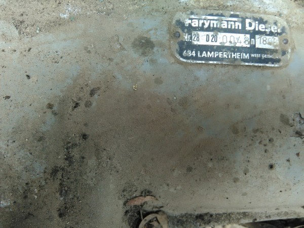

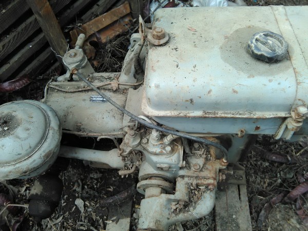

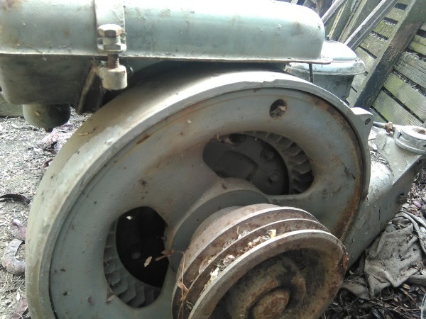

Hello!
I have a D 20 f Farymann engine.I know about this engine:The Farymann Diesel engine type 28 D20 0048 n=1800 RPM is a horizontal air cooled 1-cylinder direct injected 4-stroke Diesel engine,
year of build 1974.
Output approx. 8 HP at 1500 RPM
The production of D20 engine type was ended in 1979.
I would like if you can help me with some technical specifications.
I want to know if the piston matches and the segments go by tractor? And cuzines(roller bearing), biela (the connecting rod), arbor (Crankshaft).Thank you.

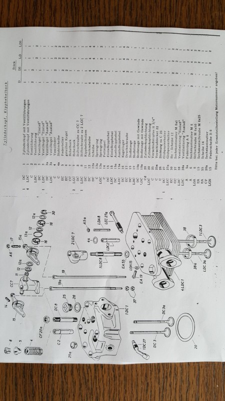

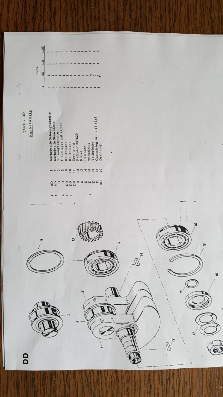

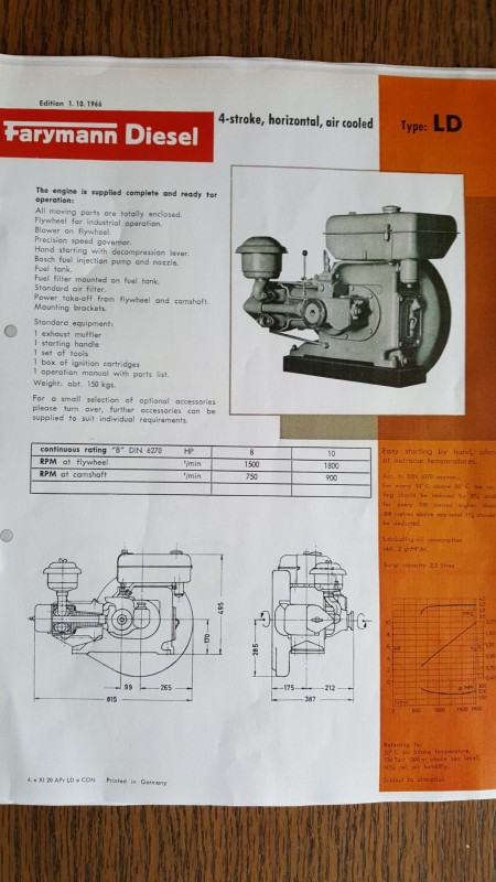

Hallo Doro,
hier die gewünschten Bilder.
