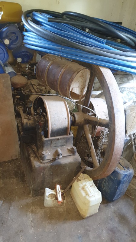

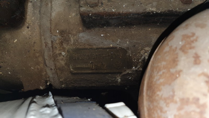

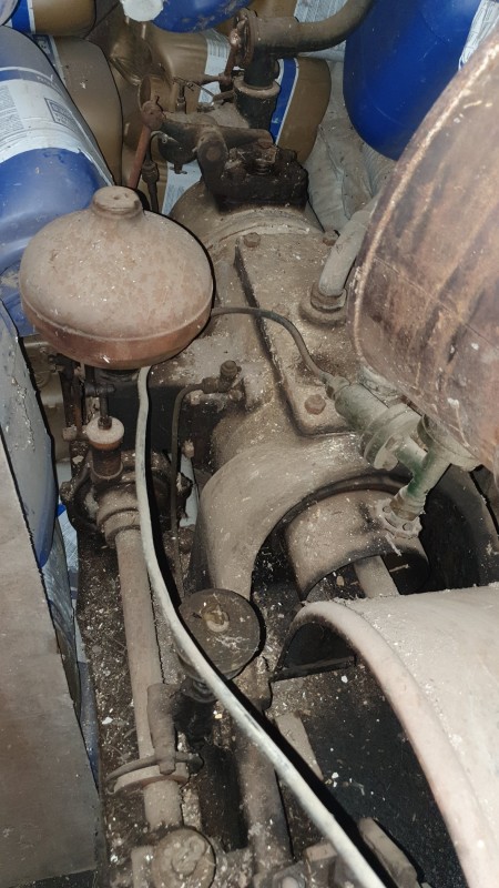

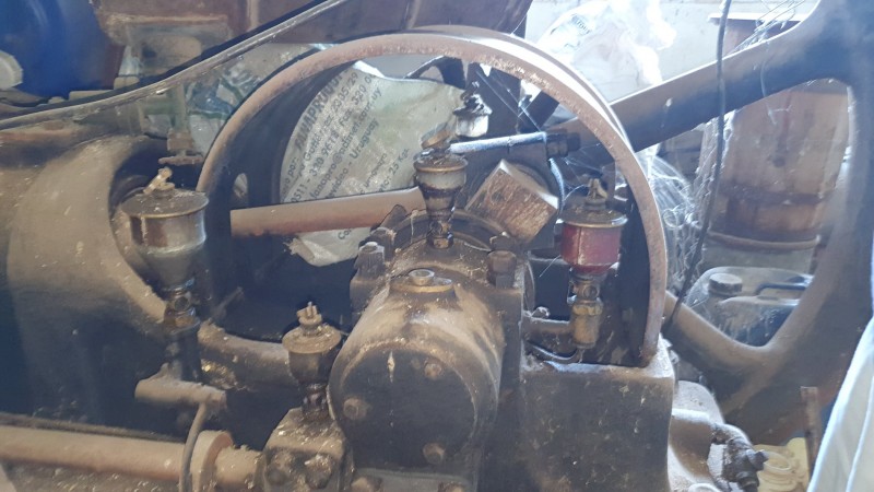

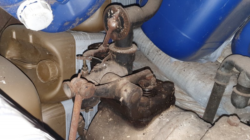

Hello, I'm new in the forum.
I'm Enrique from Uruguay.
In my father farm we have and old Deutz engine, for videos I've seen I believe it's an E20 or E12.
It's number is 53640
It's been abandoned in it's original room for 60-70 years. It seems most of it is there, and there's also a large set of tools and parts.
It used to run shearing scissors for sheep. At that time my greatgrandfather had about 40.000 sheep in his farm!!!
I believe it must have been installed around 1910-1915.
I'm planning to restore it but I don't have any information about this engine in order to know what parts may be missing, and basics about it's operation, etc.
For what I've found in this forum I believe maybe you can help me with some of that information.
I'm attaching some pictures so you maybe you can figure which model my engine is

Hello Kito :P
Welcome to our forum.
That is a very nice engine. I like it!
I can't see the magneto. Is ist in the room?
The engine has been built in 1909.
What is the diameter of the flywheel?
Best regards ;)
