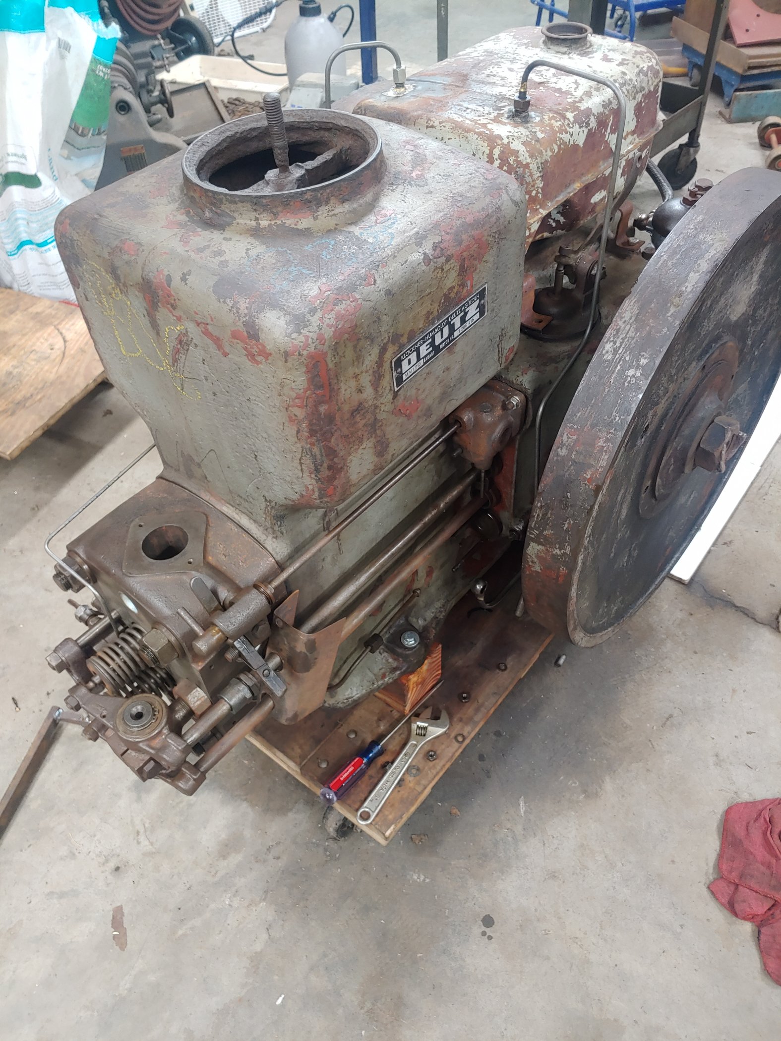

iff7378
Beiträge: 10
Registriert: Mo 21. Feb 2022, 18:08
Meine Motoren: Deutz MAH 916, Fairbanks Morse 32E14, Volvo MD11C, Detroit 4-71, Buda
Re: Deutz MAH 916 Injection Timing
Beitrag von iff7378 »

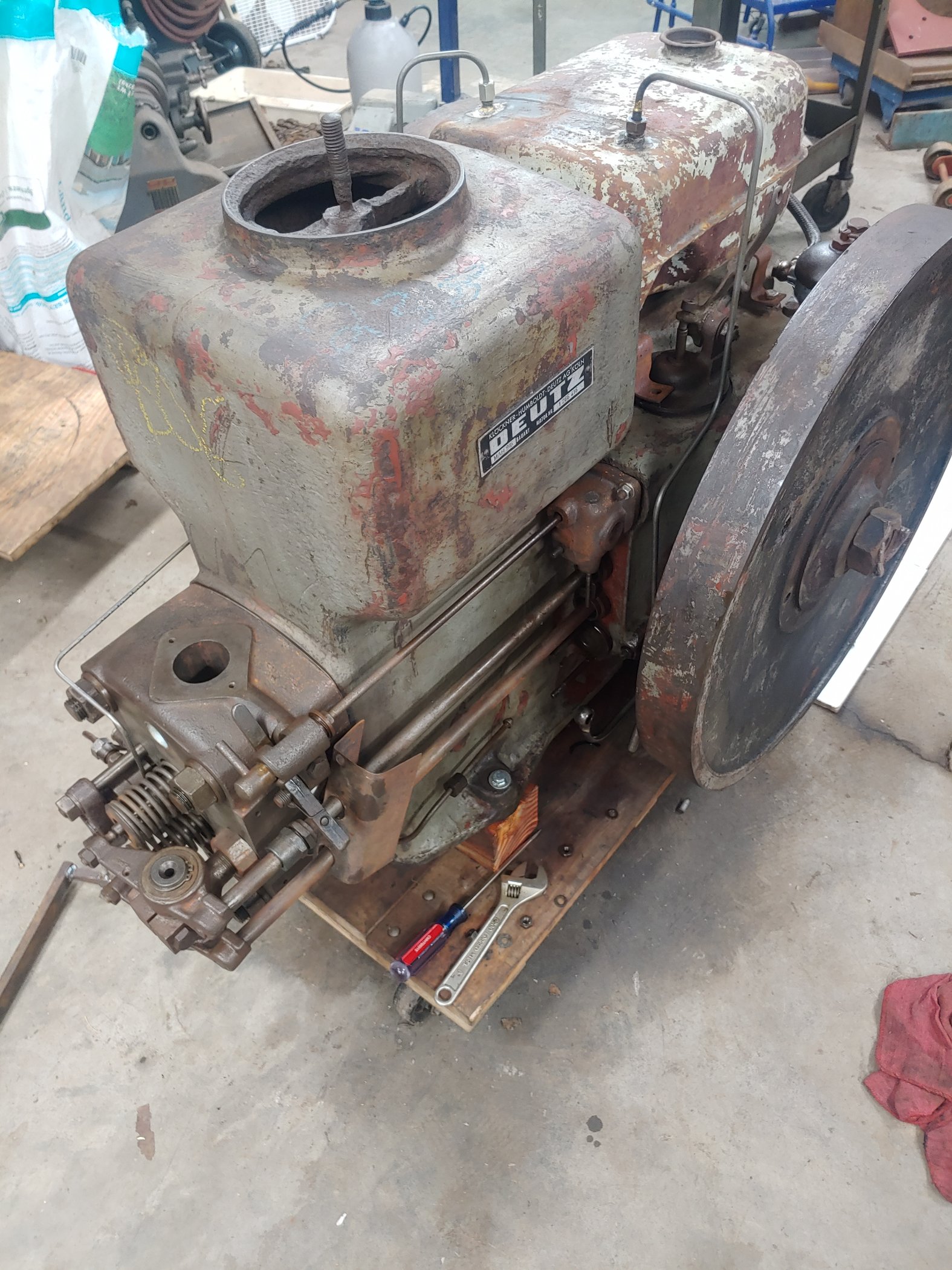

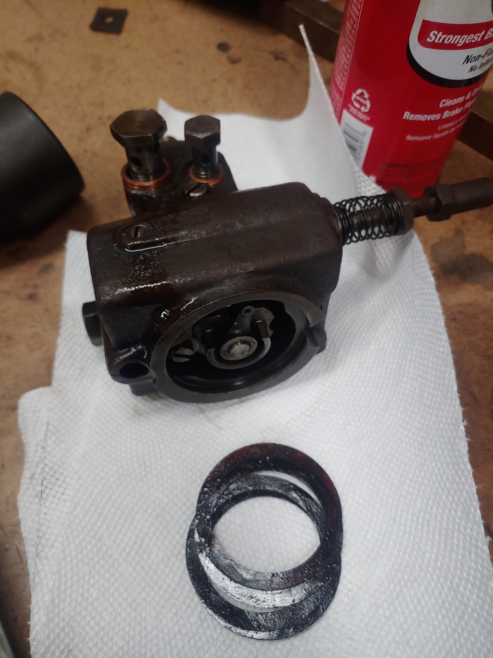

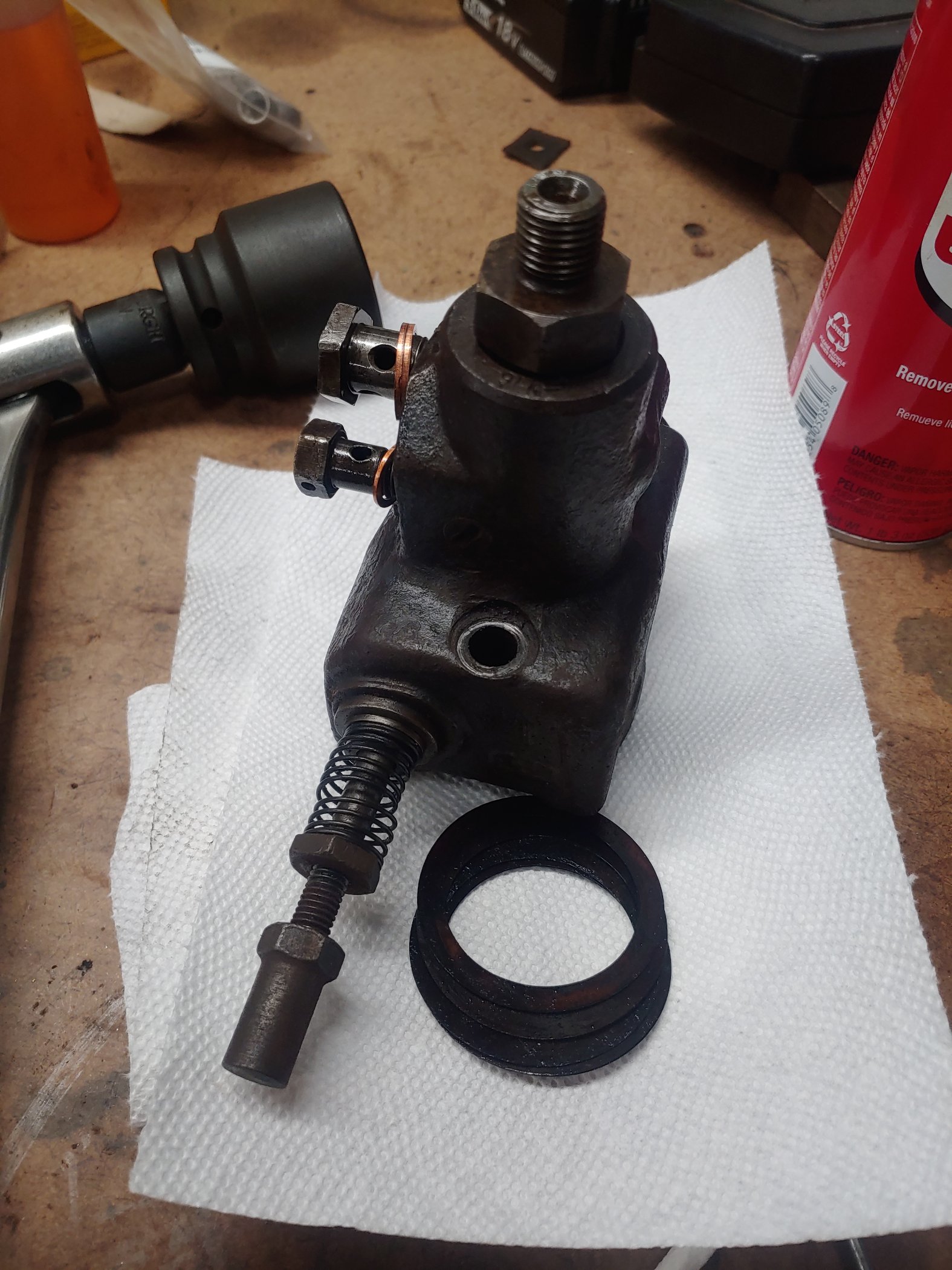

Here are some pictures of the pump and the whole engine. Does that show you what you need?
The pump had one metal and 6 plastic shims behind it and some fragments of other shims that seems to have been crushed.
I have all new shim stock to replace everything with.
I appreciate your help!
Ian
Beitrag von wollitell1704 »
Hello Ian,
yes, now I will try to explain it with my own words.

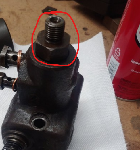

First of all you need to remove the backflow-valve(?) in the pump. So you have to unsrew this:
Screenshot 2022-07-09 201058.png (345.94 KiB) 10561 mal betrachtet

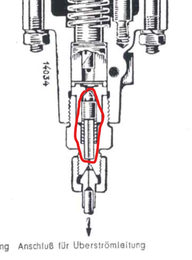

Behind it, remove the coilspring and the valve, and screw back the nut.
Screenshot 2022-07-09 201636.png (127.22 KiB) 10561 mal betrachtet
Now install the pump to the engine. How many shims you install... fell free to guess.
It might help to install a short tube instead of the tube to the injector. Now the fuel will flow out of the pump, untill that moment when the injection starts. If it´s too early, you need to add more shims. If it´s to late you need to remove some of them. When the timing is ok, just install the backflow-valve.
This is not exactly the way as described in the manual, but I was always successfull on Bosch fuel pumps.
Good luck!
By the way... the engine will run. If the timing is too early it will sound harder and getting more warm. If too late the engine will sound smooth an doesn´t have the power it should have.
