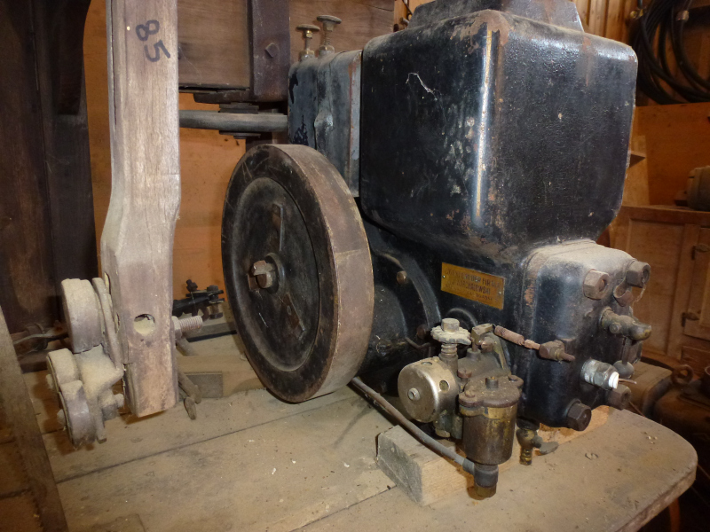

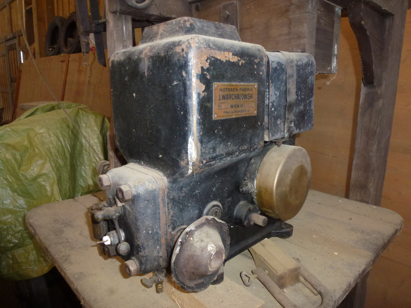

Hello,
It´s not a German engine! ;)
Your engine is a "Warchalowski" build in Vienna Austria.
It is the smalles horizontal engine built by this Company.
The engine is called the "E-Type". There exist two different Versions of this engine: 1 or 2 Flywheel. But also the Regulators, the carburateur and the ignition are different.
Pictures of my engine.
Greetings from Austria,
Jakob
