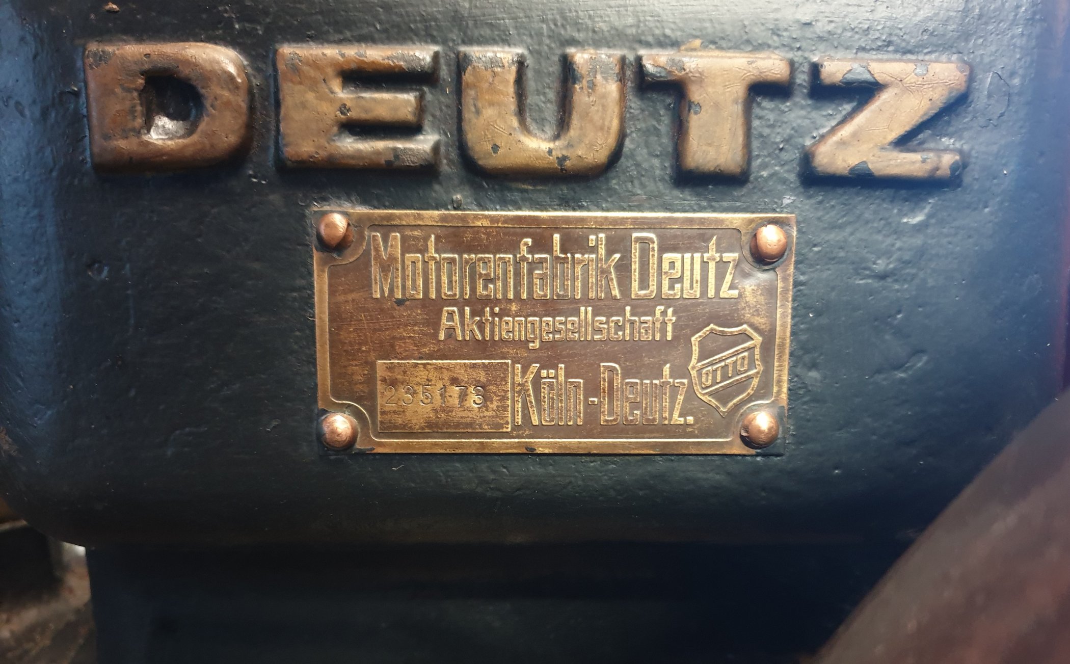

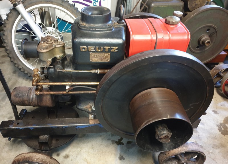

Hi All,
This is my first post, let me introduce myself, my name is Mark Grosskopf and I live in Queensland Australia, and Im searching for information on my new engine Deutz :P . I bought it a few weeks ago in the condition, of which I'M happy :lol:
But can anyone tell me what model it is, how many horse power it is and how many were made,
It was made 1940 going on the date on the flywheel.
MANY THANKS
Mark

Hello
According to your engine numer, it was made in 1929. The engine Type is probably "MA 311".
Technical data can be found here on Mathias' Homepage:
http://www.standmotor.de/deutz.htm
best regards

Hello :P
I think it is a MA511 :!:
Best regards to australia. ;)

hello, Also here ;)
MA311 has a oiler on the engine block near the tank
and a MA511 has no oiler there
